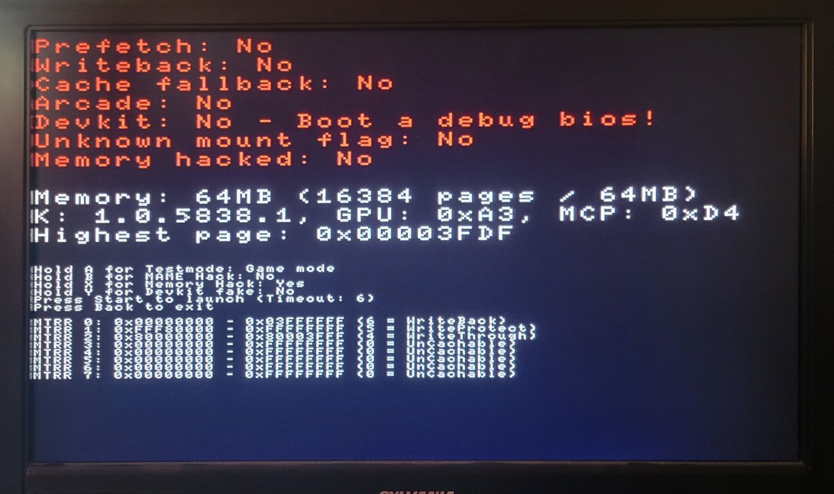

MadMartigan Posted March 30, 2024 Author Posted March 30, 2024 Looks to be the case. I guess I need to test the other console and most likely try a reflow. Quote

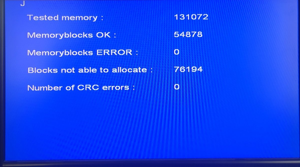

MadMartigan Posted March 30, 2024 Author Posted March 30, 2024 However, this is what XblastOS ram test shows. What is your recommendation from here? Quote
Dempsey_86 Posted March 30, 2024 Posted March 30, 2024 XblastOS can give a good test even if the ram is installed bad, I had this once to, resulting in the same like you, an unstable system. I did fix this by reflowing the ram (I had no visible shorts and all legs seemed ok). Now the system runs fine. In your case, you did pay for the installation so the best you can do is contact the installer. Quote
Dempsey_86 Posted March 30, 2024 Posted March 30, 2024 I think your m8 bios does not use the upper memory, probably not patched correctly. It only sees the first 64mb ram. What does xbmc say about ram use? Quote

MadMartigan Posted March 31, 2024 Author Posted March 31, 2024 (edited) 6 hours ago, Dempsey_86 said: I think your m8 bios does not use the upper memory, probably not patched correctly. It only sees the first 64mb ram. What does xbmc say about ram use? After a reflow, XBMC4Gamers shows 90mb free and seems to be working better. I’ve been playing Halo 2 for about 20 mins. I will reflow the second board tomorrow and see how it goes. This whole time, PrometheOS has shown 113mb free which I found weird. I don’t know how the OS ram detection differentiates from in bios though. Edit: Forgot to mention that Virtua Cop 3 still wouldn’t boot. I guess it’s possible I don’t have something installed correctly. I held X and pressed start to initiate the ram hack, but it just hangs at the pic I showed above. Edited March 31, 2024 by MadMartigan More information Quote
