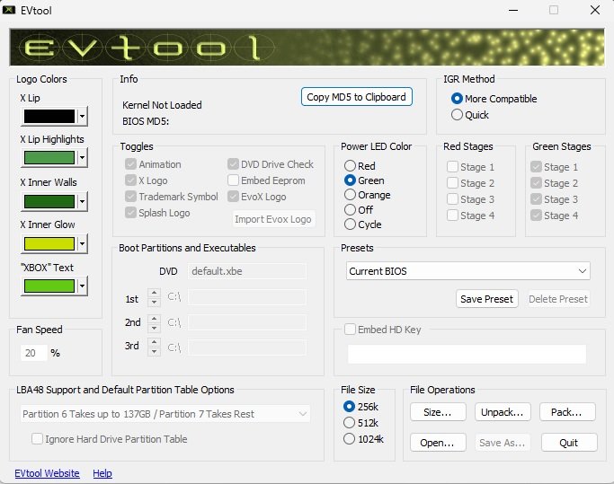

EVtool
Extracts, Compiles, and Patches Evox M8 XBOX BIOS/Kernel Files.
See about box for thank-yous (and if I left you out please let me know).

Evox Logo Notes
The logo is in DDS format.
You can create these using Photoshop or using apps which can use Photoshop
import/export plugins or with any image editor and a conversion tool. You can
find the plugin and commandline conversion utility need at nVida's web site
<http://developer.nvidia.com/object/nv_texture_tools.html>. Microsoft's DX9
SDK also has a converter, but it didn't allow enough control over the ouput
file to give me the exact format I needed.
The output file format should be 128 * 128 A4R4G4B4 DDS with no mip maps.
Exporting from Photoshop I chose 16-bit (4:4:4:4) no mip maps and left the
other settings alone. Using nvdxt.exe I use the command:
 nvdxt.exe -nomipmap -u4444 <your_image_file.tga>.
Nvdxt handles pretty much any common image format (tga/jpg/gif.etc).
I've included a sample DDS texture files for demonstration purposes.
If you get a hang after changing the logo, press eject and the machine should
finish booting. No sure why this happens, but I'll look into if I get time.
